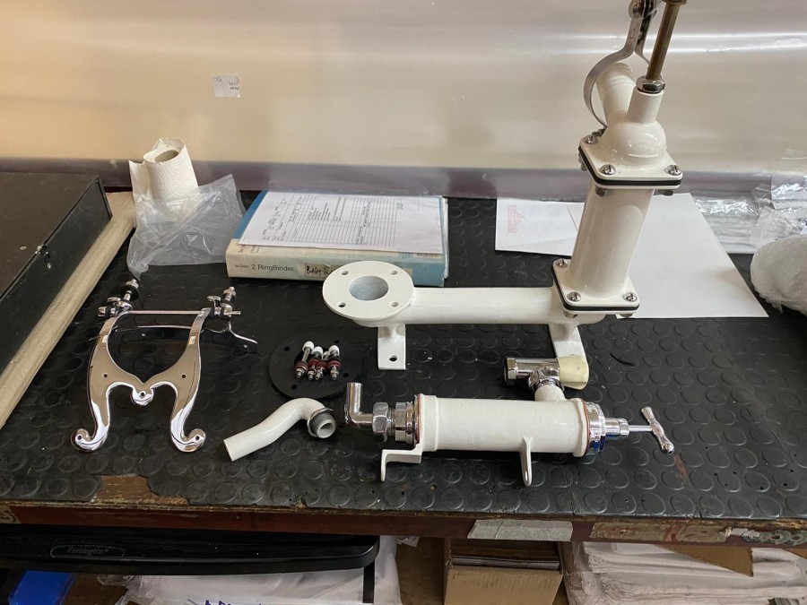

we just had our Baby Blakes restoredby Blakes & Taylors (Seasure) and I thought I'd share the result in this thread.
Haven't installed/put them back together yet but very happy with the result, they look as good as new to me.
We'd done some standard maintenance on the two Babys we have on Kairos and while this worked ok and got us through a few seasons it was obvious that they needed some more tender loving care from the experts to get them back to their former flawless glory. Someone who also has access to all the parts you suddenly find you need when dismantling something ...
Spoke to Blakes, who were very helpful, and since our bowls, seats and lids were still in good order we decided to ship only the metal (working) parts for sandblasting, re-chroming and re-pulver-coating.
Blakes would obvioulsy gladly refurbishe all parts if required though, they even offer bespoke material/colured handles, seats and lids ...
Took about one month for the two Babys to get done, and they now look  good for the next 40 years.
Some impressions below.

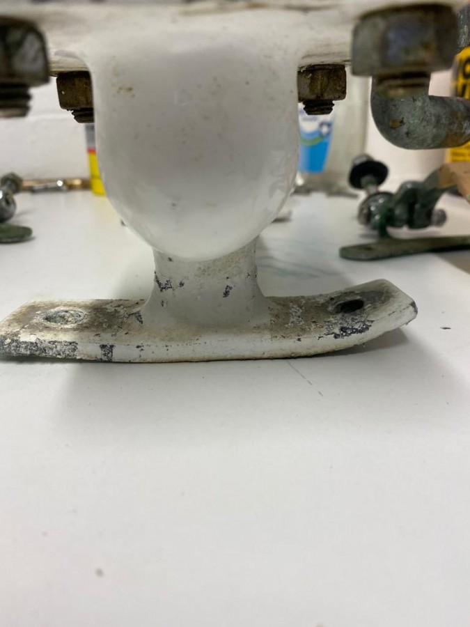

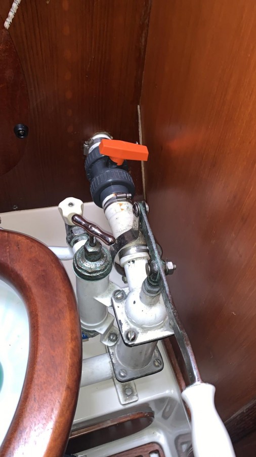

Kairos - 57/043
Starbord Baby - before restauration
Starbord Baby - bend foot before restauration
After restauration

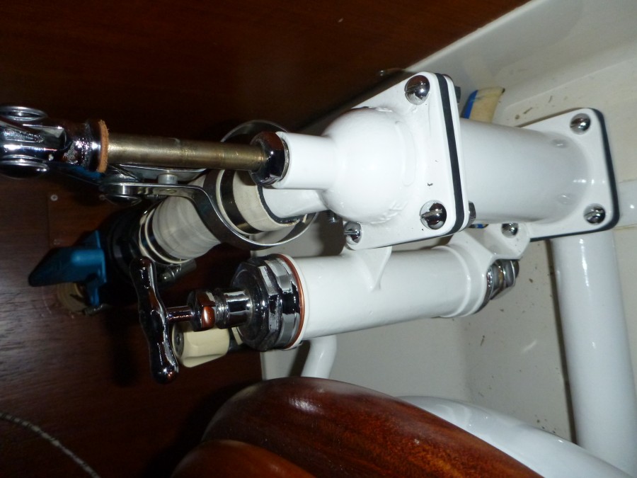

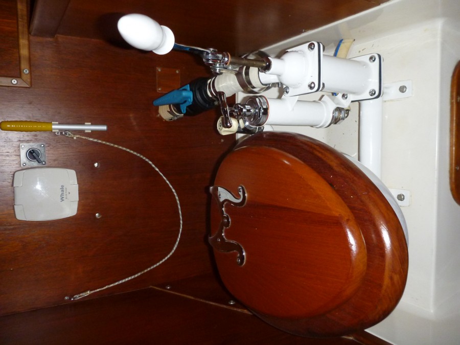

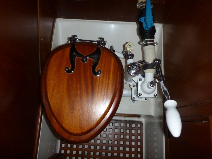

finally - almost one year after installation of the overhauled Baby Blakes - I have some pictures of the 'finished product' to post...
I blame Covid, which meant we didn't sail this year ... also means the toilets still have not been used yet hence as good as new :-)
Overall and as mentioned before a sterling job from the guys at Blakes & Taylor in Gosport - thank you!
Stefan - Kairos 57/043
