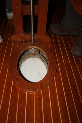

I have found this wooden item on-board but where should it go?
It have a perfect shape for the mast but is on top of the floorboards? That would obstruct the ease of getting access to the bilge.
Any comments are welcome.
Kind Regards
Bjorn

Hi to everybody,
Sorry but I have a different opinion; it's the mast ring cover of the floorboard. It's a mask to avoid that something could jump into the bilge as well to cover the sight of the bilge area that's not so nice.
To reach the bilge you just have to lift forcing small thorns plugged in the floorboard.
In my 44 is like that.
Bjorn, when we will meet in Beaulieu we can talk about many details.
Alberto

Dear Lars
i also have this ring but on the floorboardson the bottom of the mast to close gup when u move the must to bow or stern.
I am sory for my English
Andrey

Dear Lars
The hole in the table is exactly to fit the mast, but it's two pieces: one table and one piece which second part of the table what slide inn. Under table we have two plates with holes to attach the table to floorboards, this plates have many holes to change position of the table when u tune the mast. And normally this oval piece stay every time on the floorboards and move with must back and front to close hole in the floorboards because hole in original floorboards has longer oval.
