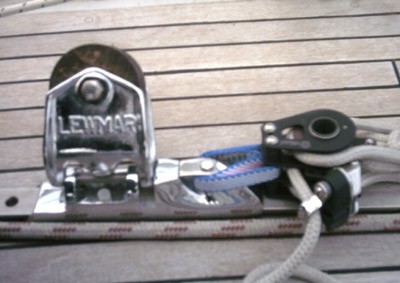

I didn't understand if you're interested in genoa travellers or in mainsail traveller, and what's the matter with them. If you are interested in moving the genoa travellers while the genoa is tight, we did a great job (here a photo). Fair winds
