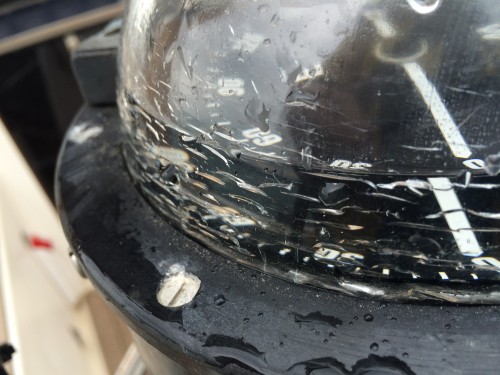

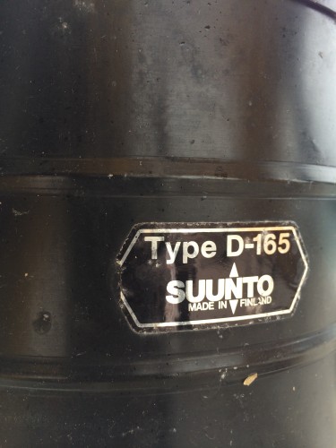

My compass lens is badly crazed and the fluid has got very low. Does anyone have any recommendations on an equivalent replacement to fit the binnacle/ or repair. Most of my enquiries seem to say they are no longer made or have parts for service.

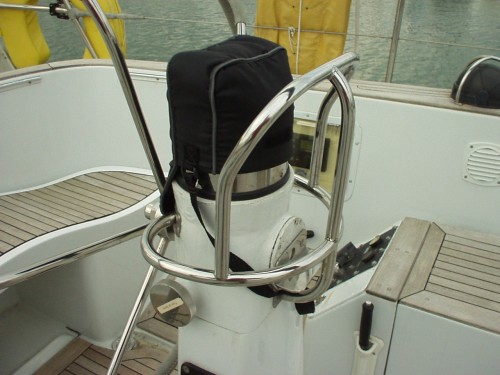

I would like to add our experience on the subject. On lots of our darlings there no protection tube over the compass and people tend to grab the dome to hold themselves when moving around. THis creates the type of crasing which appears on your picture. We did this twice until we added a protection bar over our compass. Problem solved!!
Kind regards.
Philippe 41/022
Sea picture enclosed from a Swan 65 which we copied directly!
