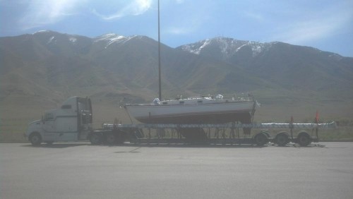

Yesterday speaking to a former Owner I learned that the mast was heightened by 3'-0"
for light air sailing, thought it looked very long on the transport trailer in a pic received, she too has an extended modified rudder.
When doing sea trials in San Fran Bay it was blowing a little over 20 and we needed to reef the main which surprised me, now I understand why.

Here is our new Swan in the early part of her journey from San Francisco to Newport parked outside of Salt Lake City, sorry for the poor image but thinks its an interesting pic of contrast. Note the length of mast, and the way the driver aligned the light pole.
