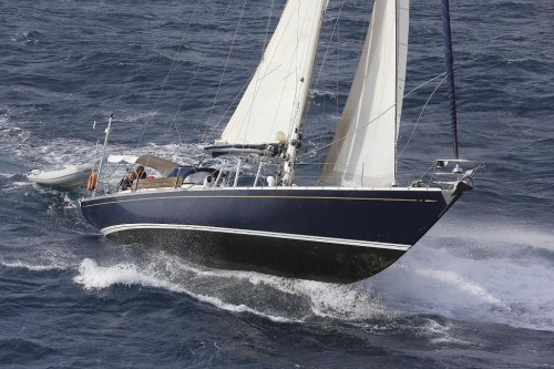

I would like to add one (or maybe just extend the "design" criterion: The overall shape of the underwater hull when it comes to beating into wind and waves. My experience with the modern, Beneteau-type U-shaped cross-sections is that they lift their foreships out of the water with the first wave, only to slam their flat bottoms right onto the next one. The double result is (a) an incredible noise under deck that makes you fear (even if unfoundedly) your boat is slammed into pieces and (b) a crew that is in a severe state of lacking sleep and rest after a comparatively short time. And what use is the boat once there is no fit crew to sail it?
Needless to say, the S&S Swans have different shapes with their deep bows, can take the waves smoothly and let their crew rest ... even when the going gets tough.

Martin, would be great if you could send me a better JPG of Age of Swan, the same you posted here.
I want to be cruel: could you imagine one of the above mentioned boats taking such a wave…she would fell apart…!

Hello Martin:
Love the picture! How did you get a picture of your boat like this?
Did you hire an Albatros and give the bird a camera? Please send me a JPG ! Pretty PLEASE !
pjlange@juno.com
Thank you so much! I'll make it my screen saver!
