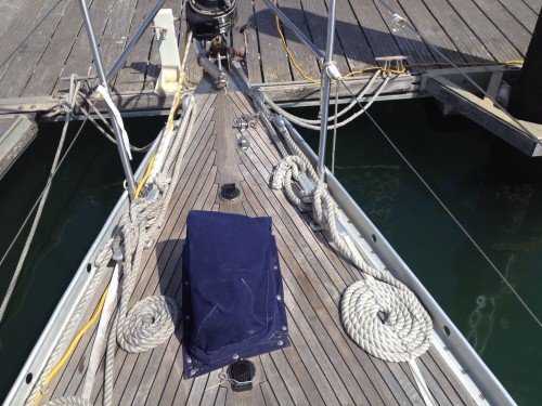

Fletch,
My solution to this "problem" was to have a Sailmaker make a watertight cover over the windlass. This keeper the watert out of the bilge and also protects the windlass, see the enclosed pic
Best regards,
Terje

17 July 2014 - 13:32
Posts: 46
Adrian, the windlass cover has worked very well. I have made 3 fairly long passages in reasonably heavy conditions after I had it put in, and the anchor locker has been dry. What I do, is store the anchor under deck and attach a thin line to the end of the chain and drop it half way down the pipe before attach to the windlass. I also stick a wooden cone in the pipe opening for good measure. A bit cumbersome, but not something you need to do very often. Hope this might be helpful.
Kind rgds,
Terje

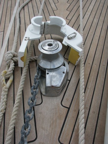

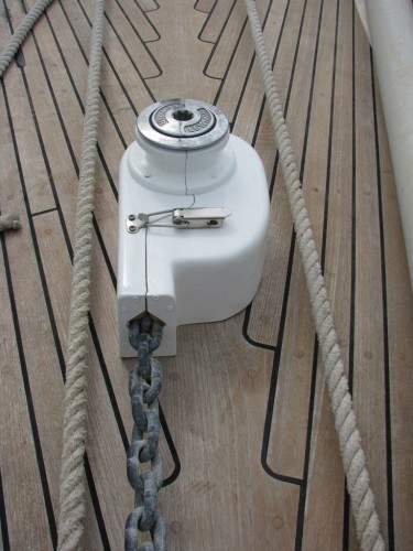

Hello every one.
Taking water thru the windlass chain inlet is indeed quite a problem. Here is our very efficient solution which I made myself during the osmosis treatment process of Soeur Anne. It took some time to make (could not sail anyway!): it's wood and polyester reinforced with fiberglass. I do feel sorry windlass manufacturers never thought of providing such a device.
19 July 2014 - 11:10
Amazing! What a great idea and realization! I am very impressed --
congratulations,
Martin
19 July 2014 - 14:22
Dear Philippe
Very good!
It appears you have flexible foam around the chain where it enters the cover. If this does not work well the watertightness can be improved further by putting a split plug around the chain where it enters. Such a plug can conveniently be cast in situ using deck mastic.
On installations where the chain pipe upper end is free - i.e. horizontal type windlass - a plug for the chain pipe hole can be cast with the same method. To be fitted with a hook at the bottom for the chain end. The weight of the chain will keep the plug in place. A lifting ring needed on the upper side.
