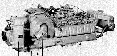

I think it would be of interest here to provide some information about the rather peculiar engine installation on the early Swan 65's. Perkins H6.354M was mostly used, i.e. a horizontal version of the well known 6-cylinder engine, but laying on it's side. This engine is unusually low, and fits easily below the saloon floorboards.
A photo of this engine here below.
Unfortunately Perkins laid down the production of this version about halfway through the S65 series, later hulls mostly got Volvo TMD41 engines, which just fitted in.
