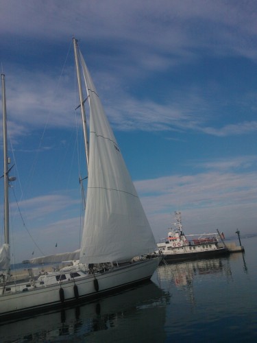

We have just had our new genoa delivered to Tigris this week. We didn't have the weather helm issue, but I was aware that there was more heeling force than there should be, going up wind. Hopefully, will the right shaped sail and low stretch Gatorback 295 cloth, it will hold its shape as the pressure increases. We have also gone for a lower centre of effort than before when it was a yankee shape. My first sail with it will be next Sunday when we start our summer holiday in Croatia from Split.
Gavin
Sail hoisted in flat calm in the marina
