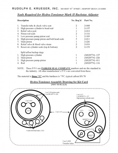

You should be able to service your Kreuger backstay tensioner yourself with off-the-shelf O-rings & seals. I have done ours on our Swan 44 a few times in the last 20 years. Once you open the unit carefully (there is a tiny spring in the bottom), it is pretty obvious. I tend to do ours in a bucket to contain the oil. Just be sure to orient the body exactly the same during reassembly. I have attached a list of seals I got from Mr. Kreuger many years ago before he retired but understand the drawing is NOT to scale. I hope this helps.

23 August 2014 - 21:35
Dear Alberto,
Candy kindly sent me a high definition file of the above drawing and I have uploaded it in the Maintenance section

28 August 2014 - 02:02
Join Date: 23 February 2008
Posts: 15
Hi, Alberto. Since the O-rings & seals are standard items, the part numbers are for Parker seals, not a Kreuger part number. Any good shop that carries this type of thing should be able to cross-reference for an equivalent part that meets spec if they don't carry Parker. I see Matteo has uploaded the better image I sent him so if you can print it out & take it to a shop, they should have no problem.
