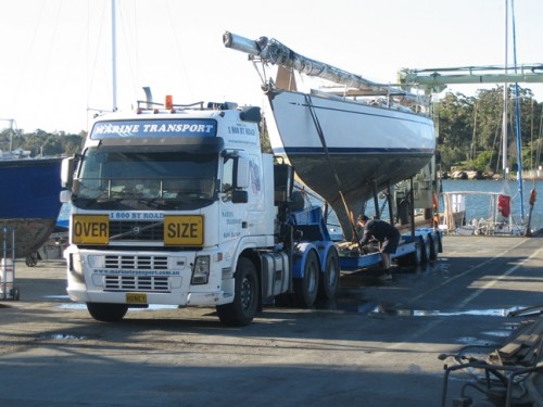

I am currently re-fitting my old 43 (Firebrand II, hull 41).  It is as you say a long process.  Fortunately, I was able to transport Firebrand from Sydney to her new home in Melbourne (900 km) without having to remove her keel.  There's more than enough to do without adding keel removal and replacement, particularly as the keel and keel bolts show no evidence of any movement, or deterioration.

I agree with you, I prefer to avoid to remove the keel, but I think Australia is not like Spain. We have a lot of bridges, power lines, etc... and the boat with the keel might be too much. I'm working in that, let's see...
By the way, your boat is still out of the water? Or do you know the height of the boat? (from the bottom of the keel to the top of the deckhouse?)
It looks like I can not go over 4 meters.
Thanks!

The height of the Swan 43 is 4.3 m, with deck gear removed 3.8 m. To this the height of the trailer needs to be added.
Pls note that some bow down attitude might be beneficial on the trailer.
