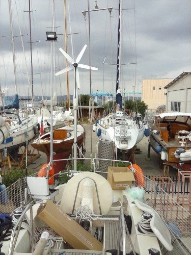

Hi to all,
I have mounted a DuoGen by Eclectic Energy too.
Good product indeed.
In My 44 the distance between static line and aft floor deck is 1100mm.
This is the most important value to choose the right tower arm and fixation.
Bst Rgrds,
Alberto
Pippus 44-011
