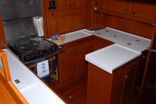

I replaced our old Eno on my Swan 41 with a Force 10. I then inherited one when I bought Black Tie and was able to buy many new parts from Force 10. Now Tigris has one which is quite new (2009) and its also a bit "agricultural" in comparison to some others, but they are robust and having good access to parts is really important. Gavin
Tigris galley and Force 10
