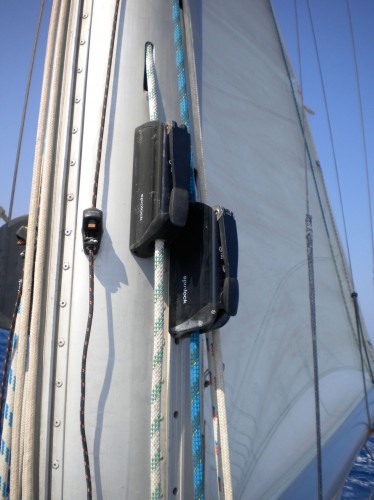

Dear Esko,
in this jpg you can see the Spinlock clutches on 47/013 VERA. These are the 0812, which are far stronger than the 0814. The 0814 with aluminum side plates might suffice on a 38 though. We cut threads into the mast and used short fasteners. This is not ideal, as the wall thickness of the mast is not huge. The blue halyard that you see in the jpg is the staysail halyard. We used the top of the Jockeypole track and cut the tread through the track and the mast to make it stronger. All in all these clutches are strong and work brilliantly. Its much easier to get a person up the mast safely, or hoist a gennaker.

Dear Hiro,
discussing the clutches and their positioning:
On 47/013 VERA, we were able to place the clutches high enough on the mast, so that one can rip the jib and genaker halyards up manually just as easy as before. The Spinlock 0812 clutch is very forgiving if you do not pull exactly inline and has very little friction. The advantage here is that, if the genaker loads up prematurely, it is not ripped out of your hand. It is also great for securely hoisting someone up the mast. That said, we do not use a clutch on the mainsail halyard, as this leads to a self tailing Lewmar 46 at the mast side. I usually get the main up to the top by hand, it just needs a couple of turns at the winch to tension it then. The two main genoa halyards lead to the mast base and back to 2xLewmar 55 three speed winches as original, and are usually not touched, since the genoa is set on a furler.
