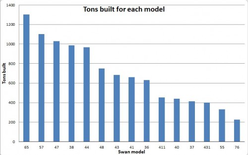

Would suggest that customer reaction is the most important indication of the best package, i.e. how many yachts were sold of a certain model. The influence of yacht size is difficult to quantify, but it is clear that big yachts can be expected to sell in smaller numbers.
If we make a sweeping simplification here, and assume that the cost/weight ratio is the same for the whole size range, the total weight sold for each model can be used to put them in best package order. Total weight equals displacement times the number built, and I have prepared a diagram where this is shown.
It can be noted that the five bestsellers stayed in production longer than the others, quite exceptional is Swan 65 with 17 years, during this time for example the engine models changed several times.
Swan 65 is also my personal favourite.
The grand total of all models sums up to over 10 000 tons of S&S Swans.

just ingenious!!!! As always you are a precious source of information and, at the same time, a smart proposer of clever and original interpretations of the data.
