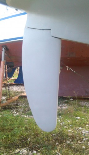

Have a note that your yacht has spade rudder, if this is correct could you post a photo?

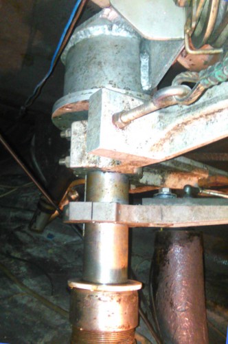

Thanks for your quick response, I was surprised to find the prop is LH rotation was that standard with the original engine gearbox combination ? A new engine was installed in the USA 1987. Images external & internal as requested.

Rudder spade
Internal arrangement

LH was standard. This will pull the stern to SB in reverse, but with the spade rudder you have better control than with the skeg rudder.
