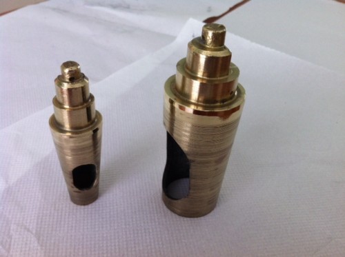

During this time my boat is on the ground, and I am personally of small maintenance jobs. Today I cleaned and polished the inner cone of the two valves Blakes. I wanted to share the results with you.
ggalizia "Cial II" 41 S & S / 04

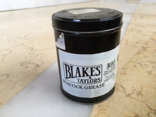

So when you assemble these valves - which type grease should be used? We have this valve service in near future.
16 February 2015 - 21:51
I have tried different brands of grease and my conclusion is that, although any marine grade grease will fit, the original product suggested by the manufacturer is indeed the best. I acknowledge that not everybody agrees especially because of its higher cost.
16 February 2015 - 21:55
Dear Giuseppe,
Daniel is absolutely right, there is a grease which you can buy here: http://www.force4.co.uk/blakes-lavac-taylors-seacock-grease.html#.VOJY6MZrSbk
It is not really expensive (but must add shipping to Italy) and perfect for the Blake seacocks

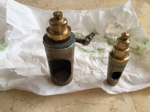

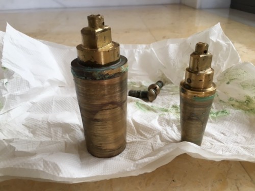

Last week Cial II, was dry in the yard, and I disassembled valves Blakes. Place a hole conditions where after seven months at sea. Now I will clean the same as last year and after putting put the grease. Also place a photo of grease used by me.
ggalizia Cial II 41/004

The only problem: they need Blake grease!!
All the best.
