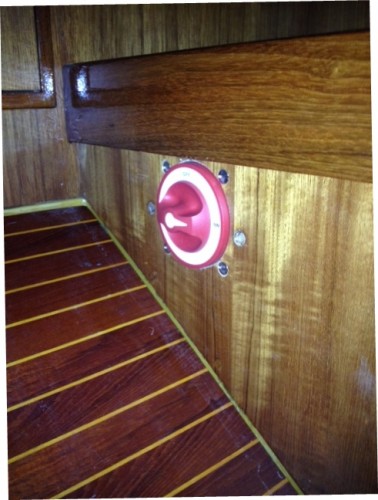

Here is the new switch installed aboard Hatha. Hindsight tells me I should have moved it another inch or so inboard to cover one of the old mounting holes.

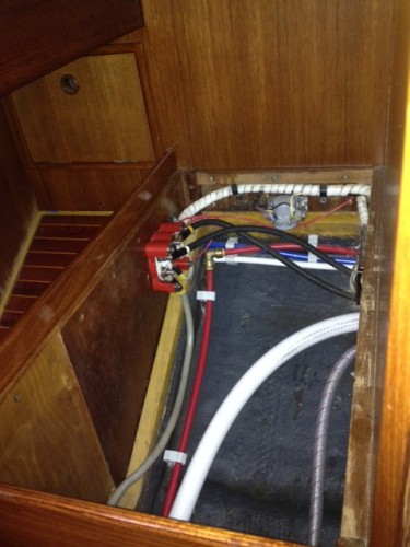

Tony H: I noticed your new water lines; can you elaborate on mfg and type? maybe another thread. Yet another project that confronts me!

Yes I removed all of the original water lines and replaced them with 3/8" Pex, which is a common plastic tubing used for residential plumbing these days.
Also replaced all valves with pvc ball valves, so there is no metal in the system anymore other than the tanks, the fittings, and the faucets.The fittings are brass and called Shark Bite, and while the tubing is very inexpensive, these fittings are not, but very easy to use.
When you are ready email me and I will send more info, or if there is interest here I will start another thread with details, photos, etc.
