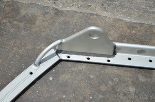

I recommend you take the Professor's advice over mine, but just to give you some confirmation, all of the aluminum fabrication we have done on Hatha has been 6061.
This includes new toe rails, mast collar, turning blocks cheeks, and their pads.
I learned the hard way that for anything you want to clear anodize after welding, your welder must know to use the correct rod, otherwise your welds can turn black. I checked my notes and have written down #4043 or 4047 rod for the 6061 aluminum, but don't take my word for it, you would be wise to confirm. Perhaps the Professor can explain.
Imagine getting my new toe rails back from anodizing, after all the hard work to get to that point, and having black welds at the spinnaker block tabs! We ground them out and re welded, stripped and re anodized, paid twice, and all is fine now. Not the first time we've done something twice on the project!
Tonyh 44 004 Hatha
23 March 2015 - 07:37
Dear Tony
The welding rods you mention are formulated for 6061 giving smooth welds by the addition of silicon, but it is the high silicon content that makes the weld turn black after anodizing.
The recommended welding rod for clear anodizing is 5356.
