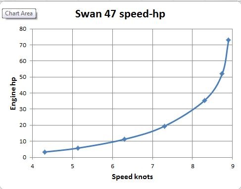

dear Lars I have Hull # 041 Tortuga, she is the NYYC version shorter mast and longer boom. Dispiacement Is around 17 tons. My engine Is too large volvo mb 31 with 100 horse power and it has many issues. What do you think about Nanni 50 horse power it has high displacement 2100, low rev 2800 and no turbo. It Is enough? Or there Is a turbo version at 1,9 dispiacement with 60 horse power. Alternatives are volvo d2 75hp or yanmar 75. or Nanni 87 that seems too Big. Perkins i need to investigate. Regards Filippo Dear Professor,

Some observations referring to Beta and Nanni engines. The Beta engine leaflets give the manufacturer's maximum power, as well as the power for pleasure craft applications according to ISO 8665. The latter is the available shaft power, and it can be noted that for Beta 60 the available SHP is 47 hp, and for the Beta 50 it is 45 hp. It appears that Nanni does not specify the power according to ISO 8665, and without this proper calculations can not be done. Kind regards Lars Dear Lars
