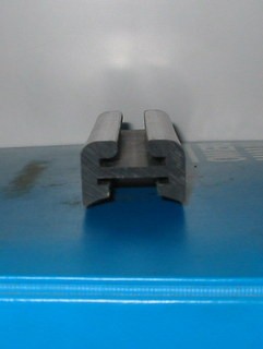

Hi Candy
I removed the original bolt rope extrusion and installed the Tides track on Hatha and am very happy with it. I chose Tides because of its simplicity, low weight , and stack height. Mainsail goes up and down with no friction. As far as stack height goes, I am 6 feet tall and can just barely reach the top of the headboard. I have only had the track on for a year so it remains to be seen how the plastic will hold up to the sun light.
If you ask them they will send you a sample extrusion and you will be able to see that it makes a really unattractive fit to our oval mast sections. They had no problem moving the slot outward about 2 mm for my order which let me cove out the backside and get a really nice fit.
Good Luck
Tonyh 44 004 Hatha
Coved track section

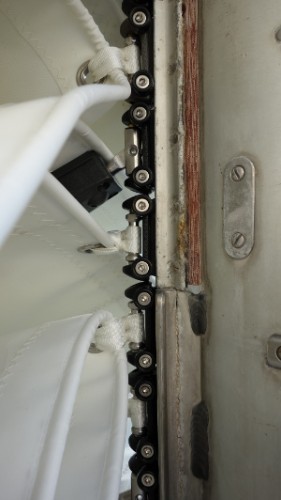

12 April 2015 - 19:23
Unfortunately I cannot find the model number on the sliders -- but one of the Rutgerson wheel sliders certainly fits great. We are very happy with that system.
Best, Martin
Stack with Rutgerson wheel sliders
