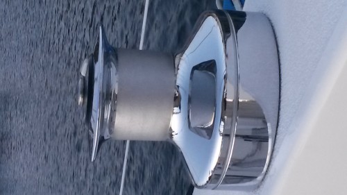

18 June 2015 - 22:31
Join Date: 01 October 2013
Posts: 33
Looks nice, just like the winches should be on 42-year old lady as SAFA is. MS.
