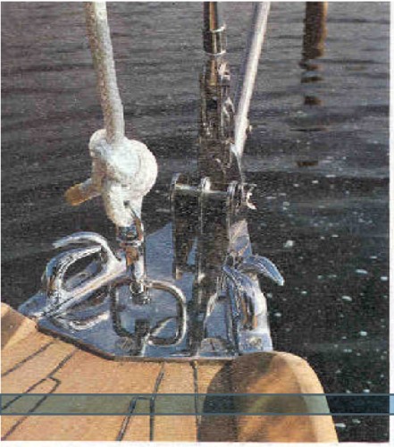

I cannot seem to find bow chocks as beautiful as these. Possibly they were fabricated at Nautor?
Any thoughts?
Chris Mabel's Casse Tete 003/43
From the original brochure posted on this site

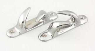

Dear Chris
Similar chocks available, see picture. Would like to ask what the length needs to be.

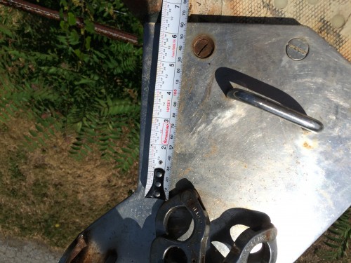

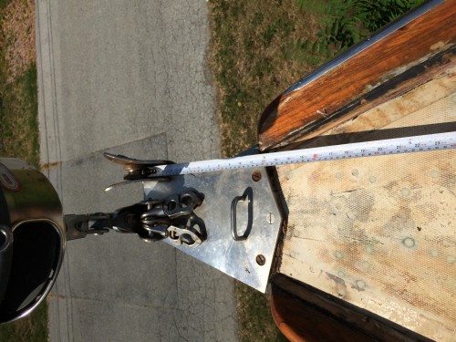

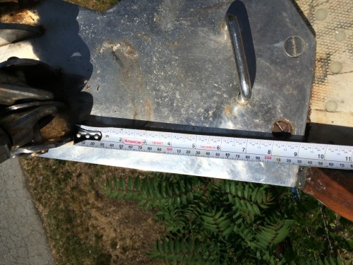

You can see from the pictures that my configuration is different from that in the brochure, specifically, I have a bow roller that may interfere with the location of the chocks.
I am interested to hear your thoughts.
With warm regards,
starboard side measurement
port side measurement
view of Bow
31 May 2015 - 15:18
I see that my pictures are rotated 90 degrees but I think you can still make out the measurements. The last picture shows what I expect is the path of the chain or line from the anchor.

Dear Chris
Thank you for the pictures
Afraid that your racing style bowroller will cause troble with a chock aft of it. The roller probably needs to be wider for accepting proper size chain, then the roller groove could also be moved towards the centerline, and the roller made bigger so the chain is higher up. You could also consider moving the windlass towards port side so the chain direction changes further away from the chock.
Needs to be verified on the boat if these proposals are feasible.

Thank you for all of your help! I have ordered the chocks you found for me - not sure the order went through but, if not, I'll work it out with Fredrick tomorrow.
I need to examine all of the projects I have going right now and see if I can actually get the boat in by mid-September. If not, I may tackle bigger jobs which would include modifications to the stemhead now.
With warm regards,
Chris
02 June 2015 - 20:36
Visa declined the transaction but I spoke with them today and it now appears to have been successfully completed! The chocks look spectacular from the picture - now I'll have to completely rehab the stemhead...and while that's off, I guess a new forestay is in order...
