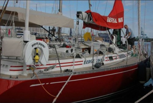

Have had my boat thirteen years but it started 35 years back when the `Berge Viking` 57 sailed here prior to Whitbread.

Dear Thorbjörn
Good that you mentioned Berge Viking.
Would like to use the opportunity to point out here that the Swan 57 Berge Viking is a good reference for how long these yachts last even in hard use.
She has logged over 250,000 miles, much of it at very high or very low latitudes. This corresponds to 10 times around the world - an huge difference in comparison to the average pleasure yacht mileage. Her original aluminium mast was used until 2011, then it was replaced with a new one of the same material. The engine is the third one.
