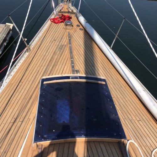

I don't have recommendations, but are you sure you need a new deck? I have a 411 with the original deck. I didn't want to pay $45k (US) for a new deck, so I've worked to prolong the life of the existing deck. It was bad in places, so I had to replace several pieces and a few wooden plugs. I also re-caulked a few joints. After that, I carefully sanded the entire deck to even out the surfaces, but I sanded off only the minimum amount of wood. The results have been fantastic.
Once I did the stabilization process above, I put on a mixture of Teak Wonder and Semco oil that several Tayana 37 owners have used to maintain their decks. Neither product lasts very long by itself, but together they protect the deck up to a year. I was going to post my results later this fall, but here's a photo of my foredeck after 6 months in direct rain/sun. If you like a silver colored deck, this may not work for you. But a light tan colored deck?
