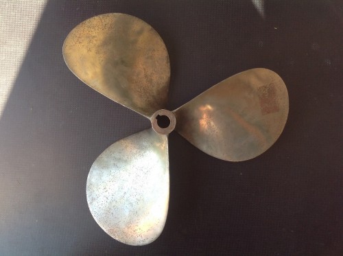

I´ve been yesterday on a flee market for boats near hamburg.
i found a verry good used propeller with nearly that size i need.
20" and 13 pitch for 60,- euro.
amazing or?
my propeller builder was calculating a 50cm with 15 pitch.
the clearence between the hull should be ok.
he can change the pitch of the prop i bought.
i will start with that propeller.
of course, it will give me not the whole sailing speed, but i have some more budged for the rest of the boat ;-)
later i can change to a folding one.
the shaft i will take in imperial and 1:10 konus.
i need some more informations about measurements, but i will open a new thread.
serious thanks, stefan

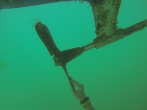

06 September 2015 - 21:09
Thank you for the photo.
This is not the original propeller position, it is too far aft from the rubber bearing, as pointed out by John.
The fouling on the propeller blades and other areas causes a serious reduction of performance.

Hello, today i`ve been by the prop builder.
he said: verry good condition and he will change the pitch to 15
they do also the rest, shaft and coupling, nuts and zink.
so i´m looking forward to come back to grenada to install the arangement.
here some pics, and it can be more stuff growing under water that will reduce speed.
i the night it sounds like popcorn.
that´s another job when my boat is out of water.
