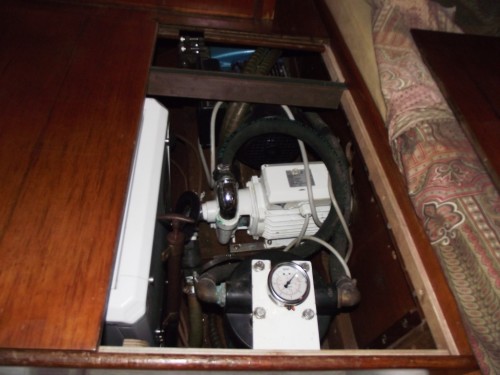

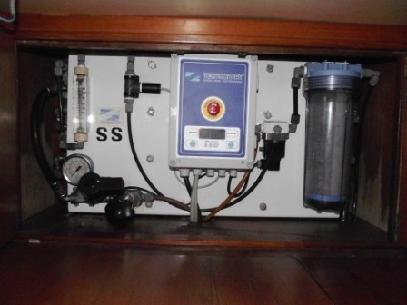

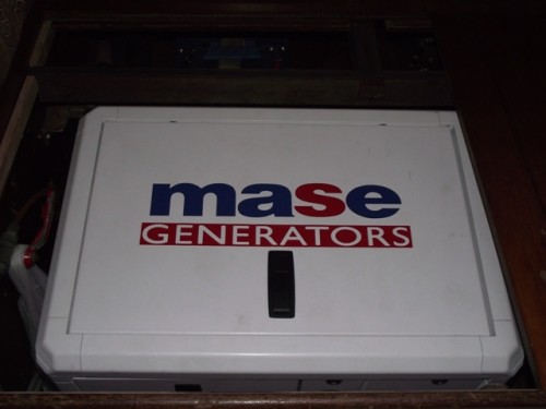

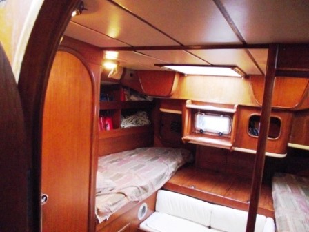

In my case the generator and the watermaker system are centrally located between the two aft berths in the vane under the small entrance ladder.
I hope you can see from the pictures
Regards, Matteo45 Grampus 47/016

My boat is a Mk I Interior plan. The kitchen area has adequate fridge capability and two cells on the sides of the oven.
There is no fridge in the aft cabin. The space abaft the ladder of the cabin is occupied by the high pressure filters of the watermaker. Under the ladder there is at starboard the generator and at port the low pressure filters and the two pumps of the watermaker.
Fair winds, Matteo
