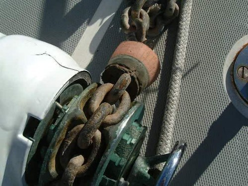

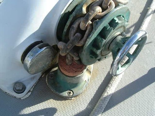

Had the same problem! But an acquaintance described a solution: Install a paper drinking cup over the chain and use it as a mold to form a rubber plug. I used 5200 (it has been a long time and I may not remember properly). But attached are two pictures: Plug in and plug out. It has worked for many years. At first, I thought it might wear away, but it never has.
