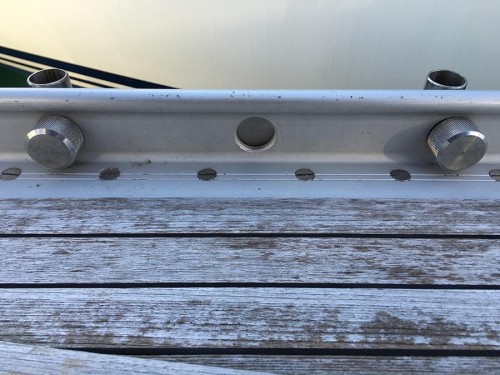

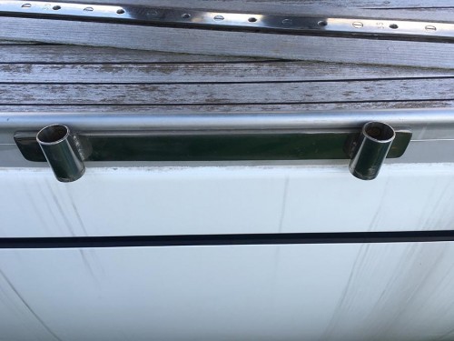

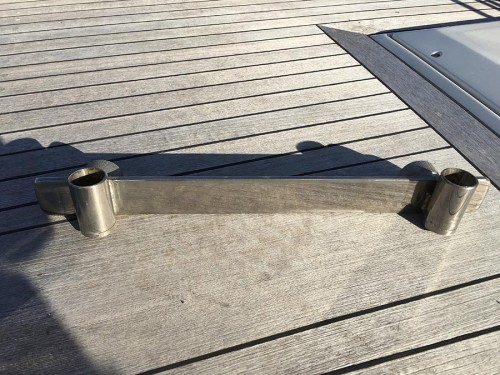

I have the solution suggested by Lars onboard Vanessa, it was very easy to have it built and inexpensive, will post a photograph next week
With this set up you can move it from stb to port side and viceversa as you prefer

please see the detailed pics of the latter base here below, it is very easy to move the stainless steel bar from port to starboard side, it fits perfectly either side.

Thank you Matteo, do the round plugs just push through the toe rail and drop down to secure or do you screw the plugs on from the inboard side, I can't quite make it out from your photos.
