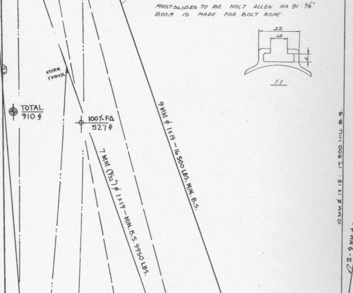

Dear Cesar,
S&S sail plan says the original diameter is 9 mm.
I think 10, and if Dyform, would be certainly enough
