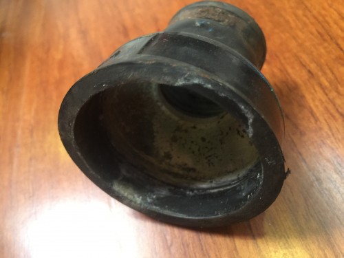

Hello, I just found and fixed the problem. It was the rubberpart Bowman 3366 that was leaking for some reason. See the pic where the leak is clearly seen. I changed it to a new one  from the new Bowman oilcooler (parts4engines.com) and the engine bay is finally TOTALLY dry!
The oilcooler I already had was totally clean and did not show any wear or tear. I suppose it was replaced during the engine renovation as told bu the PO.  Why this rubberpart did not seal is a mystery to me. It was not harder than the new part, the rubber had no cracks, ...
Bowman 3366

I am glad that you succeeded in fixing the problem.
Those neoprene caps can indeed leak if they are not correctly and cleanly fitted on the metal body of the heat exchanger and/or the clamp used is not of the right size.
