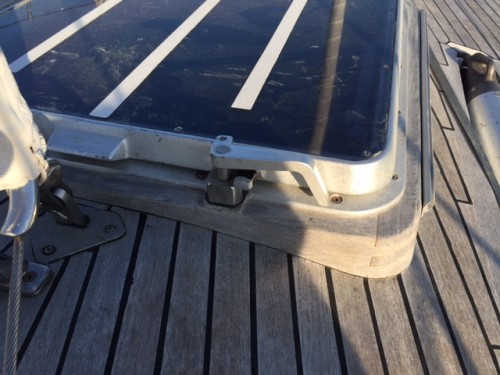

I would need some information on how to service the front hatch of a Swan 38 (1974).
Water is dripping/entering via the closing handle into the front cabin. Thank you for your kind help. Henrik
Hatch
Hatch2

Thank you for your message. Unfortunately, the Goiot full aluminium handle is not available (old model) At least, thhat´s what I got as an answer. I will try to ask Goiot directly on this part(s). Do you have any technical specs. how the mecanism works?

There may be an O-ring sealing the round shaft where it goes through the frame

Dear Lars, thank you for your message. Do you have any technical drowings of that handle?  (It looks simple)
