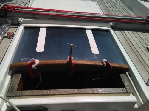

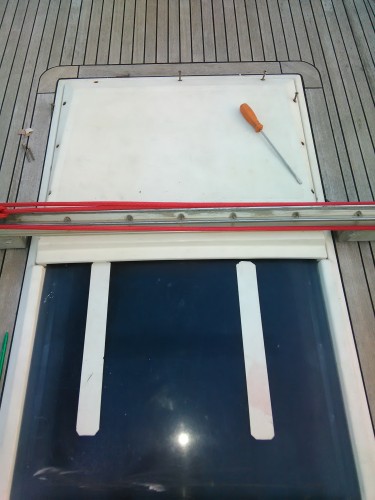

I would like to substitute the worn acrylic panel of the aft hatch, but it looks quite impossible. I thought that simply unscrewing the side tufnol slides it was possible to lift slightly the acrylic panel and pull it out.
This has not been possible, the must be a stop somewhere under the fore cover under the mainsail track. I unscrewed this cover, lifted slightly, but could not see anything interesting.
So, shall I have to unscrew the mainsail track? Unscrewing this rail means destroying it because the stainless steel is welded to the aluminum.
All this confusion for a piece of acrylic?
Has someone faced the same problem, or does the professor have such a good memory to give me a suggestion?

Suggest that you check if there are nuts below deck for the bolts holding the teak spacers each end of the sheet track. If these nuts can be opened the sheet track including hatch cover comes off, leaving the track bolts in place.

thank you for your suggestion, I was fearing this perspective because it will not be an easy job; after so many years the s.s. bolts are welded with the aluminum. We are already in the summer season, so I think that this work will be done later this year.

We did this on Sarabande when we replaced the track. For us, the most challenging part of the job was getting the head linings down in the cabin below. ( electric cables, light fittings etc ) But once they were clear and we had good access, the nuts could be removed easily allowing the whole assembly to lift off.

Yes indeed in my case also, the ceiling boards and their linings are somehow unstable for keeping them up, after so many years. I will try to make this job later this year.
