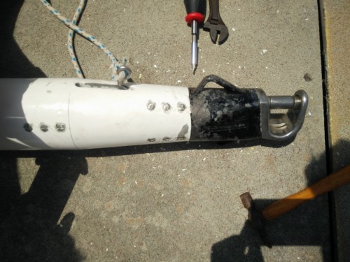

The mechanism in my spinnaker pole is not working well.
I need to take it a part to inspect and repair.
What is the best way to free up the screws which completely “frozen”
The classic problem with stainless screws in aluminum exposed to saltwater.
Have anyone been successful with this kind of work?
All comments are welcome.

We did try that method but no particular luck.
It is difficult not just destroy the screw head. If it had been Phillip screws the chance would have been better.
I will have anther attemp, though.

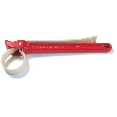

Arneoud, your description made me remind of an extremely handy tool which should stay in our boats: a strap wrench. It is cheap, easy to store and it has many applications, from the kitchen (opening the stuck lid of a jar) down to a stuck spinnaker pole or an oil filter.  If you have two of them, even better!

Indeed!! And most probably it's best to use 2 in parallel for the same torque direction in this case as with a tube on the grip of about 2 meters I'm not sure the safety margins in the design are enough to deal with the forces.. ;-)
