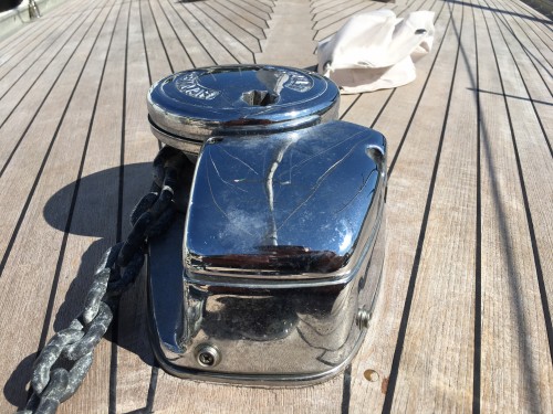

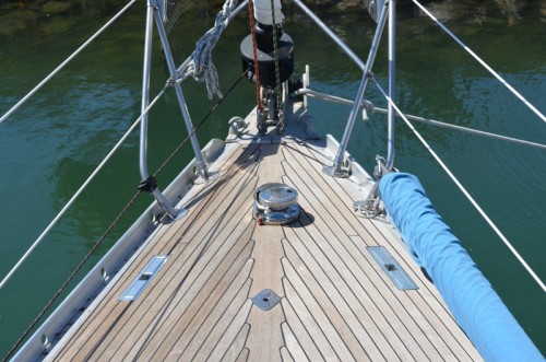

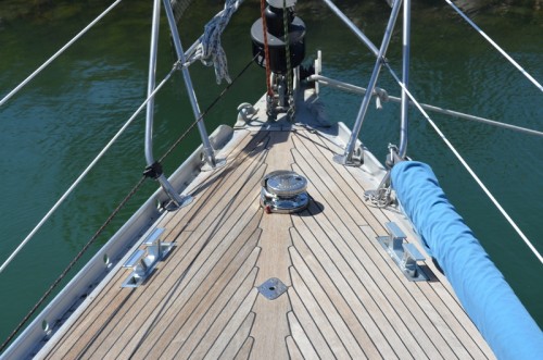

Windlass done!
Fortunately, Nautor could not provide a cleat to match the one that had occupied the place where the windlass now is. So I was forced to come up with an alternative.
My wife says she likes the pop up cleats- less for her to trip over when we wake her up in the middle of the night to gybe the spinnaker.
Tonyh

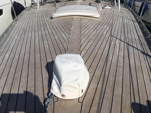

Dear Matteo
How is your cover fastened? I think I see snaps; are they tapped into your windlass base, or does your windlass sit on a wood pad?
Tonyh
05 October 2016 - 10:23
Dear Tony,
sorry for my late reply, yes, they are screwed into the windlass base, please see attached pic
