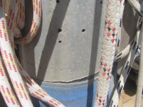

Since we are on the topic, what is your view on painting original Nautor masts (or proctor for the mizzen)? My masts are neither anodized nor painted. Pitting is apparent here and there.
Thanks for your input.

31 August 2016 - 14:58
Dear Michele
Painting will enhance the appearance of your masts, and is easier to do when the masts are not anodized. Anodizing would prevent the paint from sticking well to the surface, and it must be removed before painting.
The preparation of the surface and priming are very important parts of the job for achieving a proper result.
With the time panting begins to flake off from edges and corners, and this ultimately determines when renewal is due.

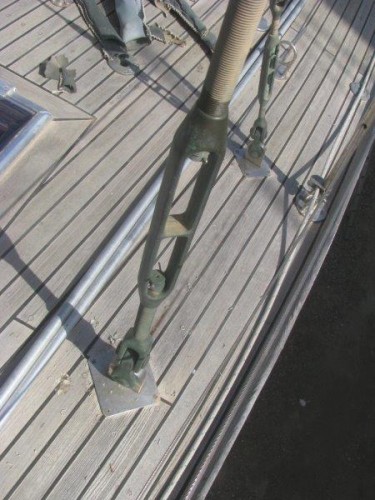

Could it please be advised if bolt at lower part turnbuckle can be easily dismantled for inspection and also for surface treatment?  Those on `Caid`look great!
Thorbjorn/Ravn 411/36
31 August 2016 - 21:04
Dear Thorbjörn
Assume you mean the pins attaching the turnbuckle lower end toggles?
These pins are pressed into place, and can not be removed

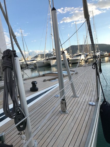

As this job is being carried out it is a good opportunity to review the Turnbuckle cover situation.
When I bought 055/12 it had stitched leather covers. Pretty but horrible to inspect and they do not last long. Last year I had some rather naff velcro/vynil cheap covers made up. Can live with those as they can be inspected, but ....
When she went round the world in the first Withbread, from the pictures I had, it had long alluminum tubes in a mat finish.
I've seen some Swans sailing with polished tubes.
What is your reccomendation on the subject? Dyameters involved are quite large, and long. Selden Turnbuckle covers are perhaps an option, but again not a particularly pretty one.
Thanks for any input.
Michele
28 April 2017 - 16:28
Dear Michele
Thank you for the photo.
Leather covers are not recommended
The original turnbuckle covers were of aluminium tubing with anodized finish. If you prefer polished stainless this only means a change of the tube material, the ends are plastic and remain the same.
Maybe you noted that Selden covers do not rotate. The original covers can rotate, and this makes it easier for the genoa to pass over the turnbuckle and cover.
Will see if I can find some specifications. Dimensions for your turnbuckles and chainplates would be required.
The main shroud lower toggle position looks a little odd?

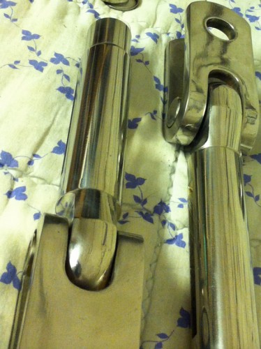

28 April 2017 - 20:12
Dear Michele,
I agree with Lars, the original one, Nautor made, could rotate and were fabolous, I had them on 38/067 Only You. As 47/069 Vanessa did not have either alluminum tubes or leather covers (nice but not really practical), I bought the Selden ones (pls see photo below, and they do not rotate), a good even if not perfect commercial product, check their catalogue as as far as I remember they just have two measures.

02 May 2017 - 12:46
#17
Dear Michele
In your photo posted 28 April it appears that the main shroud toggle is partly recessed into the deck. Is this really the case?
