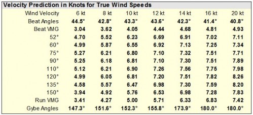

Are the velocity prediction tables different for a 38 with a one ton rig? Are these tables also available?

Enclosed pls find the VPPs for the short rig, the differences are small. Presumably the short rig is well suited to San Francisco Bay conditions?

Thank you for the supplied speed table!
