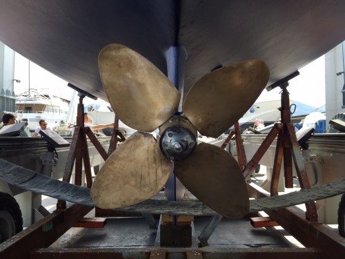

I have been offered a 19" three blades Brutons Autoprop (H6-534).
On Vanessa I have a Yanmar 4JH3 HTE, Kanzaki gearbox KM4A gear ratio 2,63, shaft 40 mm.
Previous Vanessa's Owner installed a four blade MaxProp Easy, not a bad prop but quite noisy (maybe because the blades are very flat?), and four blades are (in my opinion) a bit too much for a sailing boat.
Autoprop promises miracles with their props, not only in terms of speed/consumptions, but even with noise/vibrations reductions, which they say are very low.
I would like to know your opinion on this!
Thank you very much, and fair winds!

In your case, Matteo, I understand that that your problem is the noise coming from this propeller. I do not understand if you are meaning vibrations, because I am not able to perceive the noise of my propeller  as distinct from the engine when it is on. Clearly, when you are sailing engine off you keep the gear on the reverse.
Regarding my three blade Max Prop, about fifteen years ago I was feeling there were too many vibrations in the boat and, apart from changing the boccola, methinks cutlass bearing in English, I left the propeller at the maxprop workshop in Milano, they cleaned the propeller, and they equilibrated perfectly the ambaradan, which looked balanced, shining and new.. Perfect final result in the water..
You live in Milano and you might check with them. In case try to swap your four blade propeller with a three blade from them... Four blades are more expensive and may be good only if there is no free space underhull, which is not our case.
I have to check, but I think I have a 21 inch propeller..

The Max-Prop blades have fairly thin edges, and if they are not properly rounded off but have sharp corners this will cause noise and possibly vibration. Check this when you lift the yacht.
The propeller shop should be able to improve this if you do not want to do it yourself.
