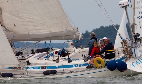

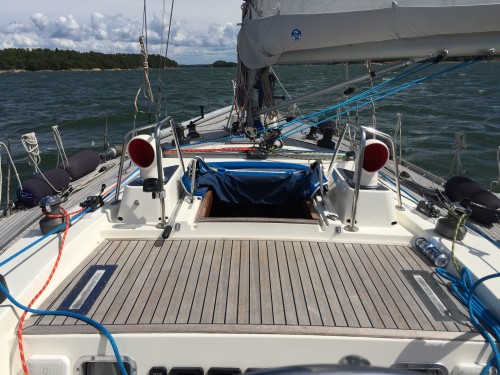

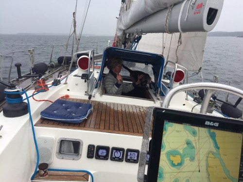

Dear Diogenes, here's our solution in CAID, also a 431.
From the pictures You can find that:
- main sheet is the blue 14mm line. It is sheeted to BOTH SIDES of the Yacht to the Lewmar 55 ST winches. We keep the Antal sheet jammers open when sailing and those ST-winches will hold the line.
- main sheet car can be adjusted with the red and green line seen at the pics. It is sheeted with the Lewmar 40:ies ST winches, one at both sides. The Antal winch jammers are kept open as seen at the pics.
We only close the winch jammers when the going gets tough.
