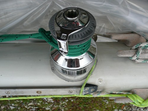

You mentioned that you have 2 Lewmar 30 ST on mast. I have the same winch on starboard side of mast, and I am looking to put a winch on Port side of mast as well, but the existing base looks to small for a Lewmar 30 ST. Have you mounted your Lewmar 30 on the Port side of mast on the original base from that side? Or did you create a new base for this. Any pictures of your port side mast setup would be greatly appreciated.
-Nathan
10 May 2008 - 21:09
Dear nathan,
they have been fitted on the original welded plate and are exactly the right size (look at the above pics).
If you want me to take more pics, please do let me know, I will do next week

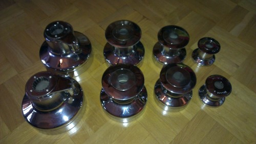

BTW: My existing winches were re-chromed. The end result was more than I could hope for. Price per unit was 125 eur (in Finland). The picture doesn't do justice to the perfect looks...

Hi Esko,
Great looking winches! Could you tell us in which company you had them rechromed? I've been thinking of starting similar project with my winches as well.
Best,
TeemuP (Eleanor 43/014)
29 November 2013 - 20:07
Join Date: 22 July 2013
Posts: 10
Dear Teemu,
Re-chroming was made by this company http://www.niklaamorautio.fi/. It was is easy to send the winches by Matkahuolto (local Finnish bus agency...) to them. Please say greetings from me!

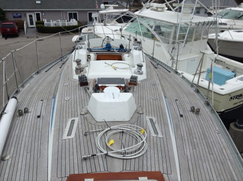

Corazon has a self-tailing winch on the mast. I now also have an Andersen electric on the starboard side, just aft of the mast, which i use for the main halyard most often. Like Matteo, my boat has had many winches taken off. We have the primaries and secondaries in the cockpit, the mainsheet winch of course, the main halyard winch, and one each self tailer either side just aft of the mast - forward of these two we have a cluster of stoppers each side, so we can control now (6) lines using the two winches (originally it was (5), but we added one on the stbd. side for the main halyard, which, prior to the converting that winch to electric, was always winched on the mast). There have been one or two times in five years of sailing the boat where I wished I had a free winch forward, but only for a moment, because in fact I can do whatever I need to with what I have.
Fair Winds,
Geoff, Corazon, 411 #41
midships deck showing winch and stoppers

the post you cite is very old because in the meanwhile I did change the mast winch with a selftailing and I am very happy with it. Indeed it is pretty necessary to make life easier and I was definitely convinced after I found an original interesting document from Nautor where it is written that the ST main winch was an optional at purchase time of the 411.
I reckon you found a very good compromise in modifying the deck arrangement because you were able to avoid the removal of the dorade boxes.
