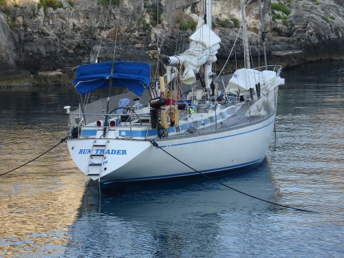

Dear Jayne,
We bought Rumtrader (S&S 47 n° 59 year 81) and have still some patches of orginal runing rigging. We are planning a major change of the rigging (runing and fixed) and therefore read your questions with great interest.
For halyard knot we use the "noeud de capucin".  I do not know the name in english.
Before going to into detail I have to improve my knowledge of the english sailing terminology.  This is my first contribtution to this wonderful internet site
