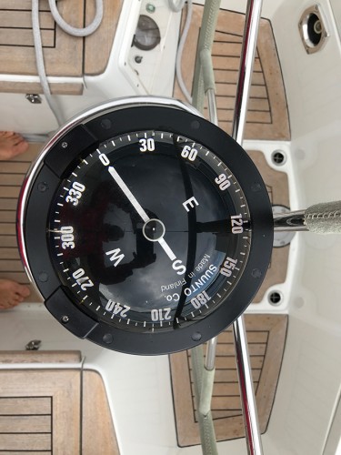

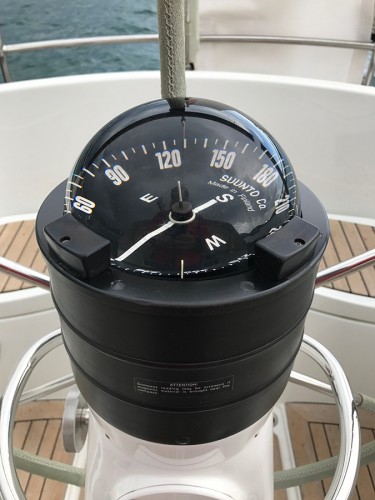

last year I sent my Suunto D-165 to Fuselli in Genova and they completely rebuilt it (they did the same about 10 years ago with the Danforth Constellation i had onboard 38/067 Only You), try to contact them. They are very good and honest:info@fusellifassio.it
D-165 Suunto after it has been overhauled
