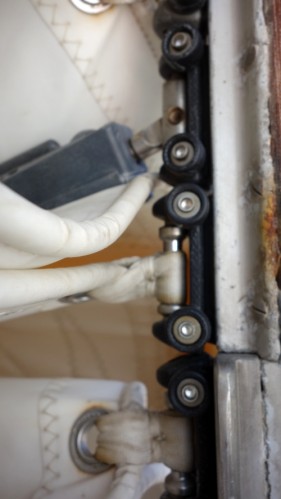

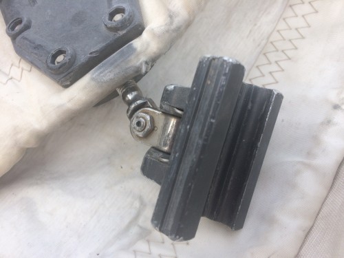

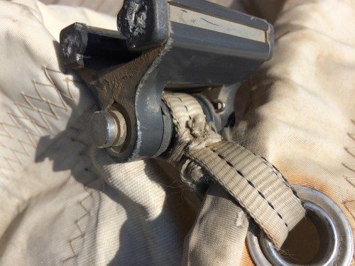

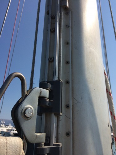

I am struggling to replace the inner sliders that fit into my cars for my mainsail track on my Swan 57, Scaramouche. It's an old system and the riggers I've contacted in the UK and Greece have no suggestions. If I cannot source the sliders or new cars I'll have to replace the whole system. The last photo is a car missing its sliders.

I am not sure if the measures of the main sail track for the 48 and the 57 are the same, but of course Lars will know. If they are: I replaced the old sliders with batten cars by Rutgerson. For my main, the battens use
Rutgerson item # 1530-23-05 with M10 threads
and the sail in between is attached to cars of the type
Rutgerson item # 1530-23-10
The cars have considerably less friction than the sliders so I am totally happy with them. The wheels take the pressure on the outside of the track while a sliding T part is inside the track. I got them via Gotthardt in Hamburg and can provide you with an item number if you need it.

Swan 57 originally had a sail track for 1" internal slides, and this track is visible in your photos. An additional track for the battcars has been added on top of it, and a peculiar feature is that there are cylindrical screw heads located in the track recess. Unable to find such a track from the big suppliers, perhaps an outdated model?
The slide rods are round plastic bars with a specific length, maybe you could have some made up for you?
I think Age of Swan has 7/8" sail track, Martin could you pls confirm? Then the same Rutgersson cars do not fit the 57, but there is probably a suitable model. Should I check?

Age of Swan indeed has the 7/8" track with an inner space 22 mm wide, so Lars is right that the model cannot be simply transferred to the 57. However, there was a considerable number of slide/cars by Rutgerson we had to choose from, so I am confident you will be able to find something -- even something that passes over the bolt heads in the track.

Please do check if there is a car that would fit the track. I've tried having rods made up and gluing them in place but the originals have ends that help them stay put. Without these the replacements soon fall out.

The Rutgersson Limousine Battcar 1540-23 with M10 or M12 thread should fit your original track provided the additional track is removed.
Further you need a headboard car C23, and intermediate battcars 1528-23
It is suggested you discuss this with your sailmaker.

One thing you might do before you dismantle the additional track is trying to find out (from a former owner) why it was installed in the first place. I have a small number of details on Age of Swan where something seemed to be a strange solution, but after removal I found that there was a reason for that - either to remove a chafing, or to circumvent a damaged part. If the latter applies to the mainsail track, removing the additional one will just leave you with another set of problems.
