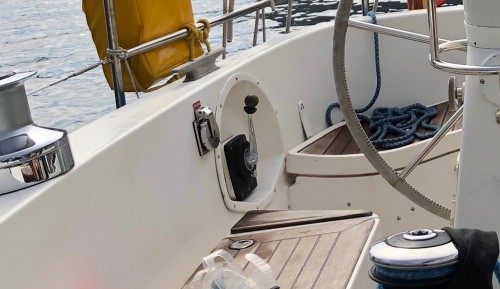

I already noticed for a while that a lot of noise in the cockpit comes through the place where the engine throttle is installed (see photo). That piece of GRP is much thinner than the structure of the cockpit. I put a thin layer of heavy insultation material at the back of it, without disturbing the throttle mechanism, and it did the trick and reduced noise in the cockpit noticeably. This may be specific to our 411, but you can easily check that on your boat, by comparing noise levels to both sides of the wheel.

The noise level through the control panel in the cockpit sounds unusual, could it be that the control cables are in tension, and transfer engine vibrations to the panel?

The cables behind the control panel are fine, it was really just more noise pentrating from the aft of the boat into the cockpit through the thin control panel. There is no insulation along the shaft, so noise can freely go under the floor boards of the aft cabin and from there following the draining canal into that aft of the boat. The exhaust system is also not insulated, so another source of noise in the aft of the boat.
