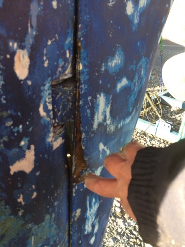

In ours Swan 37 skeg is extended with acid-resisting steel. The extension part is partically delaminated from skeg. How this must be repaired?

Is there laminate on top of the stainless or vice versa? These materials do not stick well to each other, because stainless quickly forms an oxide layer on the surface in air, and this prevents the resin from attaching properly. A special procedure is recommended, described in an earlier thread. Basically wet sand the stainless surface using epoxy as wetting agent, this prevents oxide from affecting the bond.

Thanks a lot of your answer. GRP is on the steel. If I understood correctly wet resin separates plain steel (AISI 316)  from air while sanding?

Yes, you are right, resin or primer prevents contact with air.
Maybe not necessary to cover the stainless with laminate, would filler do the job?
