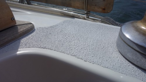

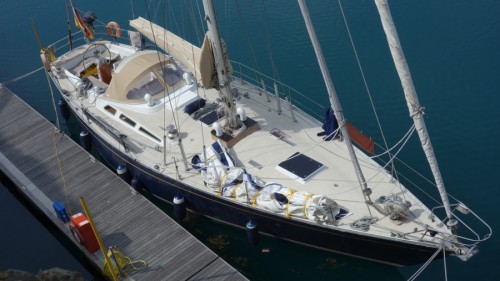

about a year ago I had to remove the old teak deck (the boat looked then very similar to yours) and chose a non-skid paint. I'll attach some pictures with the results. The product is called Deck Line, the manufacturer is MAP Yachting; I ordered the set in Germany and can of course help if you should need a contact.
It is a two component PU (I think) paint that can be mixed to different colors. I found it easy to apply, as it is simply rolled on with a "structural" rolling brush, something that feels like a hard sponge. The spongy cells pull the wet paint upwards, so the result is a non-skid surface. The feel of the deck is more or less like the running track in an athletic track, somewhat rubbery, and unlike the teak is does not get hot in the sun. Besides, it is easier to wash down. One of the pictures is of the cockpit coaming, just to show that curved shapes are possible.
I chose to paint the deck "unbroken" without creating sections, in part because I found it difficult to design as there are no obvious edges. If you decide on separate sections, you will probably have to paint the dividers first. That does have an advantage, even beyond the water run-off: you can paint in smaller sections. If you decide on large areas, you will need to work with two people, one painting and one mixing the next batch of paint so you can continue wet-in-wet. If you're alone, you need too much time to mix, so you will see where you started anew after the paint had already dried a bit.
I guess it is obvious that I am quite happy with the paint ...
