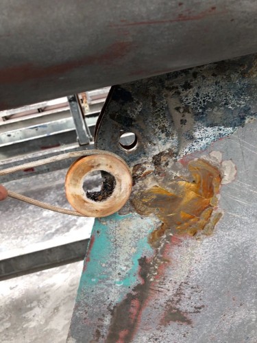

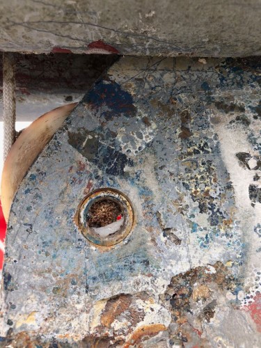

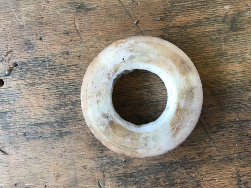

Swan 47 CB, sheave on the centerboard Dear S&S Swan 47 CB Owners, from time to time please check the sheave on the lifting point of your S&S Swan, there may be a galvanic corrosion which eroded the shaft. It happened on my 57/069 Vanessa. It is very easy and inexpensive to replace the shaft and the sheave, provided the boat is ashore of course! Of course there is a galvanic problem (see the daggerboard) which is now under surveillance and resolved during the next winter. Fair winds! matteo (47/069 Vanessa)
You can see the sheave is not aligned anymore with the shaft because of the corrosion of this one Eroded sheave ![]() |

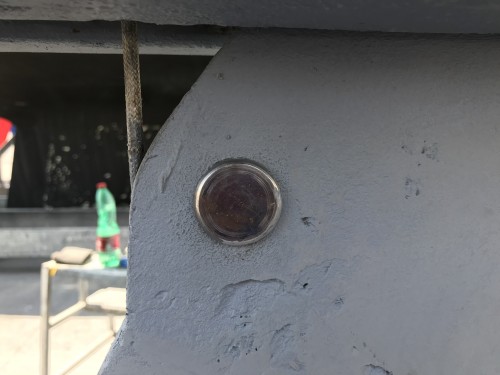

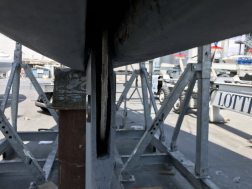

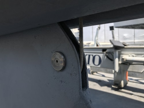

![]() New shaft and sheave on place ![]() ![]() |
