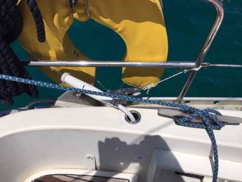

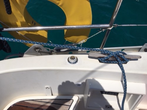

since the head/shower compartment is all varnished we never dry it after a shower. We sail in the Med and there it anyway dries quickly. When taking a shower we close the door to the saloon, and leave the door to the head and the forward hatch open, which creates space and ventilation. Nowadays we rarely use the harbour showers.
We recently also installed a cockpit shower which we like a lot - it is hardly visible. This one can be used for a regular shower at night in an anchor bay.
