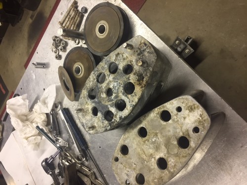

Attached please find apicture of one of my primary turning blocks, partially taken apart.  The sheaves were frozen and the appearance was terrible so I asked a friend to see about dismantling them for restoration.
I just talked to him and he is struggling with the 4 machine screws which are used to bolt the aluminum block to the SS base.  You can also see from the picuture significant corrosion.
So, I'm still thinking that I should pursue this effort to maintain the original "Swan" appearance.  However, it would be a lot cheaper to buy new ss versions!
What are your thoughts.

I understand very well the problem because it is the same I will face shortly.  I have a few comments:
1) I think that you were pretty lucky in being able to free the sheaves; you can now fully restore their movement by rebuilding/redesigning the plastic shims, the bushings, the axle and possibly even the sheaves themselves.
2) I am not sure but apparently the part which is badly corroded is only one side in contact with the SS base, a part which is not visible.  If this is so you could consider machining it to make it flat again and/or partly rebuilding it with thickened epoxy resin.
3) whatever you do, try to avoid ss/aluminum direct contact.

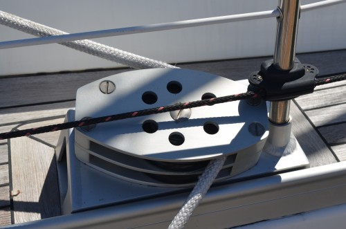

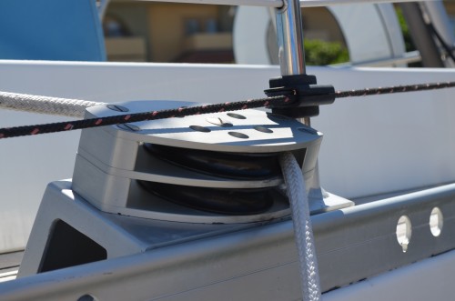

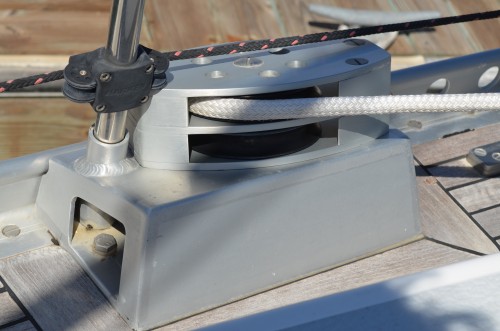

Hello Chris
I'm sure I showed these DIY blocks off to you when you were here, maybe you've forgotten.
We had the same problem on Hatha, and after looking for suitable replacements decided to make them myself.
The housings are made up of 3 "cheeks", we used 3/16" 6061 aluminum, with 1" spacers in between to provide space for the sheaves. (working from memory).
We used Harken roller bearing sheaves, 105 mm I believe.
As I recall the Harken bearings are a little wider than the originals, so when making the template for the cheeks you'd need to make those a little wider.
I wrote a program and used my cnc in my cabinet shop to make the parts, but it could be prettty easily done with your bandsaw, drill press, flush trimmer on your router, and a belt sander. I relocated the holes over the bearing races to allow fresh water for washing.
Once you cut out all the parts you can bolt everything (minus the sheaves) together and clean up the outside with your sander.
I had a machinist drill the center hole and make the axle pin, then took them apart and sent everything out for anodizing. I epoxied everything back together on final assembly.
It's been at least 3 or 4 years now and those bearings just spin with a touch of the finger.

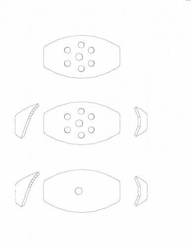

I've included here a drawing of the parts, and looking up the file refreshed my memory so I need to make some corrections and suggestions.
The cheeks are 1/4" 6061 aluminum, the spacers are 1".
I now see that the center hole for the axle was in my program, so the mounting holes were drilled then the outside of the housings were smoothed after the axle was made. The top cheek is threaded for the axle, and the hole in the bottom cheek does not go all the way through. It is 3/4" diameter, so the axle has a shoulder machined into it to stop against the bottom plate. The threaded top of the axle is 1", while the body is 7/8" for the sheaves.
All in all, not a really difficult project, but a little time consuming. But those sheaves run like a dream!
My way of cutting the parts with a cnc router was a little bit problematic. If I were to do it again I would look into having them made by someone with a plasma cutter.
15 September 2018 - 19:02
Sorry, clicked the wrong button!
Here is drawing
Tonyh
