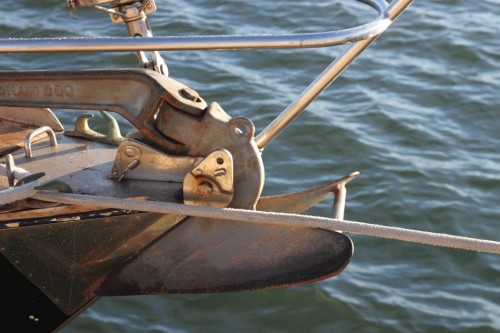

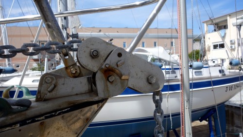

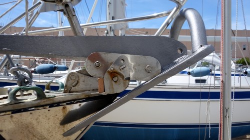

Not sure if I posted this before (six years ago) ...
When we bought our 48, the boat was equipped with a CQR which fitted nicely into the bow roller.The anchor was held in place by tensioning the chain on the windlass -- very comfortable. Unfortunately, we often needed more than one or two attempts to get the CQR to hold in the ground, so we changed it to a Bügel anchor. The design is very similar to the Rocna.
With the different shape of the Bügel, I encountered the same problems described in this thread. The round bar (which lends the name to the German "Bügel") hit the pulpit, so it was difficult to secure the anchor in this position. What would have been needed was an extension to push the anchor outward (forward) for storage, free of the pushpit.
I had a stainless steel extension made that does exactly this. It uses the bow roller threads as an axle, so I did not have to modify anything on the boat. When we take the anchor in, the diagonal part corresponds exactly to the angle of the anchor, so when the chain is tensioned, the anchor is pulled against the extension. I attached some pictures of the construction.
Of course I am very willing to answer questions, comment on the design, or send the drawings ...
Martin (48/039)
Stage 1: CQR anchor in position on the bow roller.
The extension part uses the same threads as the bow roller.
Stage 2: Bügel anchor in position.

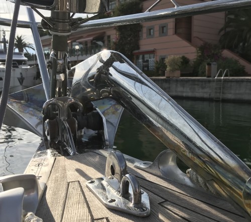

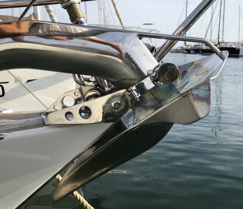

25 September 2018 - 18:36
Dear Esko,
here you are.
